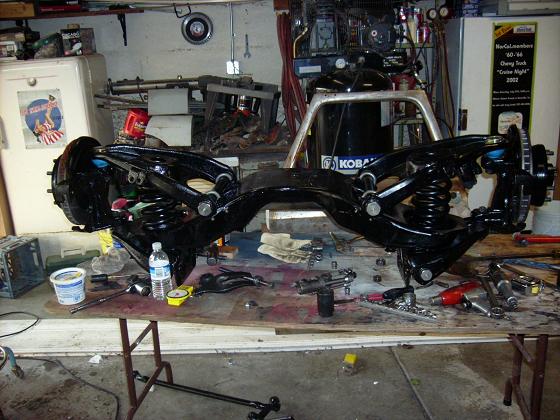

Well it's been a long time coming, but with the engine, exhaust and transmission completed like I wanted it, the time is finally here to start phase 2 of the mechanical "restoration" of my truck!
My plan to upgrade my steering & brakes was to swap out a complete front suspension from a later model truck - cross member & all. Not only does this fit my modular approach to minimize down time, but it also makes it easier to avoid geometry issues and replacement parts later on. I can also sell my vintage "power assisted" steering parts at the swap meet as a complete package.
Some time ago (about 4 years ago) I purchased a front end out of an '89 3/4 ton Suburban:
After a not so brief intermission, (2 years recovering from a near fatal aortic aneurysm) I was finally able to complete the re-build:

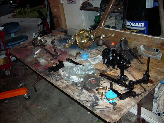

Here’s most of the parts I'll need to complete the upgrade:
New calipers & pads, new outer tie rod ends, new dual mastercyl/brake booster kit adapted for a '66 Chevy truck, a re-manufactured p/s box from the '89 3/4 ton 'burb, new sway bar bushings, brackets, good used pitman arm (89 burb), good used inner tie rod ends, good used idler arm/center link and good used sway bar brackets for front cross-member.
The huge 1-1/4" sway bar, the re-man p/s pump and the REZ adapter kit aren't pictured. I still need to purchase p/s hoses, brake lines for the fronts, and some new dust covers for the inner tie rod ends.
The plan is to remove the front clip of my truck intact, jack up the frame, suspend the engine, remove the existing front-end (cross member & all) clean & POR-15 everything, then install the new cross-member, the master cylinder, p/s box, p/s pump and all the lines. Then put the "dog house" back on as it was - well, that is except for new isolators under the core support.

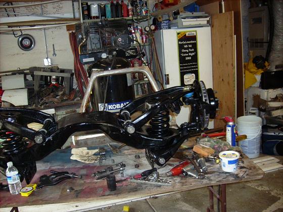

You have done a nice job of cleaning up the front crossmember. Amazing how a garage accumulates stuff, isn't it! Looking good!!!

It's amazing how a minor thing like a near fatal event can change your priorities, and stall your progress. I've got back and knee problems and it's taken me several weeks to get half done sanding my truck for new paint, but I'm greatful I can still do it at all.
It's good to see you're again capable of moving forward. What you've done so far looks great.
For what it's worth, I also did the front suspension swap with the engine in the truck. To suspend the engine, I bolted a couple of chunks of frame rail from the donor truck, to the 1955 engine mount holes at the front of the block, and rested the other end on top of my frame. It was simple and didn't require an engine hoist to be in the way.
Also, on the POR-15, you may want to check out the following link, and the testing link within that thread that shows a salt water test comparison: http://autobodystore.com/forum/showt...ht=por-15+rust
We painted my entire chassis and suspension with POR-15 about 10 years ago, and I must admit I'm disppointed with how it's held up. When I wash the crud off there are quite a few rust pits popping through. I found out about Zero Rust after I had completed the chassis, but I've been using it on everything since and I think it holds up better. My truck did see 9 years of Idaho winters and gravel roads so maybe nothing would have held up. Just something to consider.

Day two: Partial frame-off
My buddy John came by today and we kicked some tail!
This is what we started with at about 11:00 this morning (John needed his beauty rest) While I was waiting for him, I hooked up the battery and just drove it in under it's own power (easier on the back)
Jacked 'er up, yanked the tires. those drums are almost new - shame!
Dropped the sway bar & the steering box.
Plucked the brake booster & master cyl.
Then we popped the motor mounts free, attached a chain to the front of the motor.
Then we shoved a 2x4 under the front pulley to support the engine - worked like a charm!
We dropped the old cross-member out and the frame was bare finally! Really dirty, but free of parts.

Day three - Re-construction: "Let the Games Begin!"
John & I started the day off making a list of what we wanted to accomplish today, and then another list of what we needed to buy to make that happen.
Today's objective was to get the crossmember installed, engine bolted in, steering box & brake booster installed. We tooled down to the hardware store & dropped a cool benjamin on some new shiny zinc coated grade 8 bolts, nuts, washers and some shop supplies.
Then we headed back to the shop to dig in.....
The "new" cross member goes up for the first dry fit!
The six 1/2" bolts on the bottom fit perfectly and so did 2 of the 4 on top. All together 4 out of 14 had to be drilled.
This bolt on each side needed to be "augered" out a bit...
And this one needed a new hole to be drilled.
New hole drilled....
This one elongated just a smidge.
