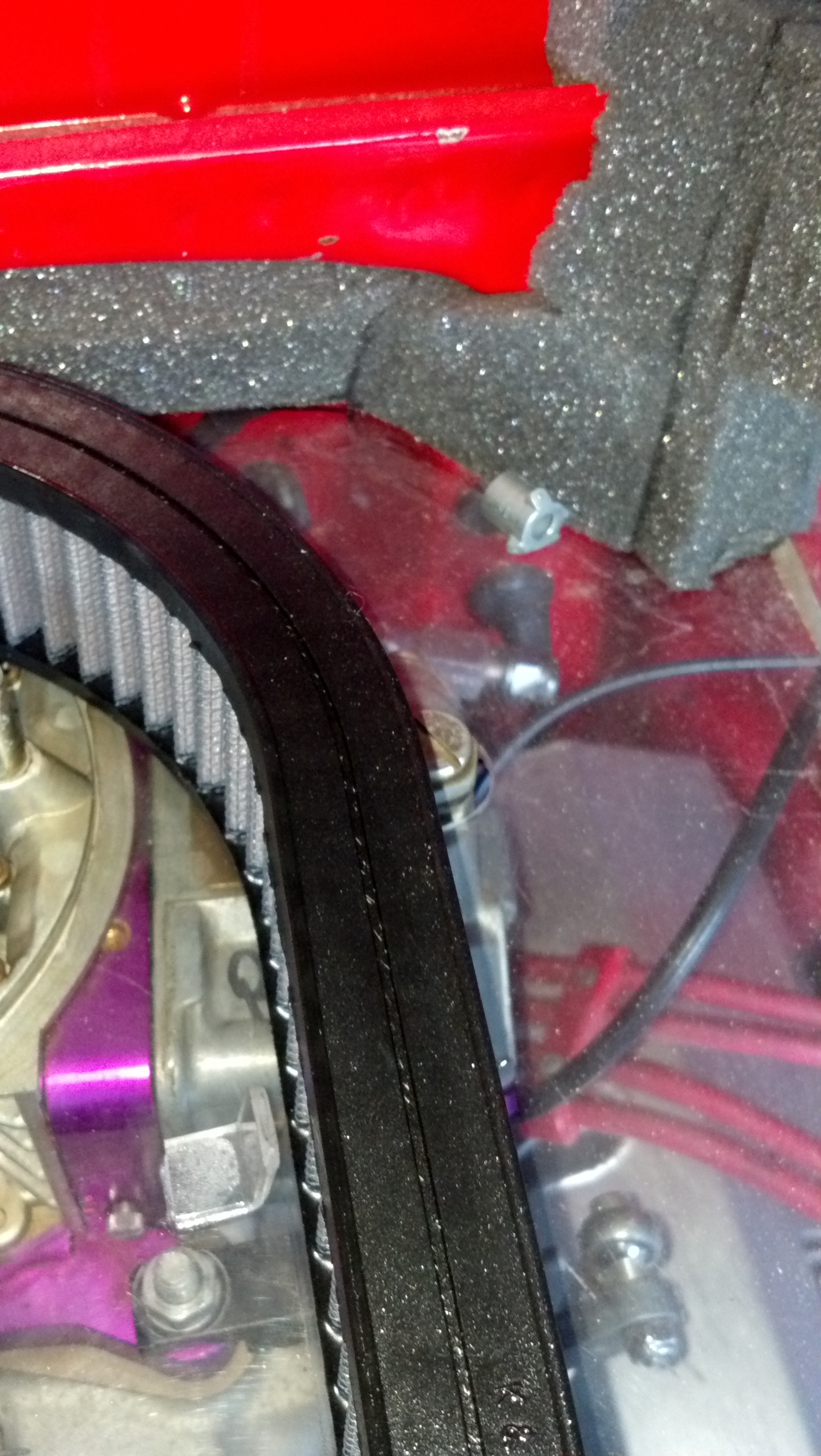

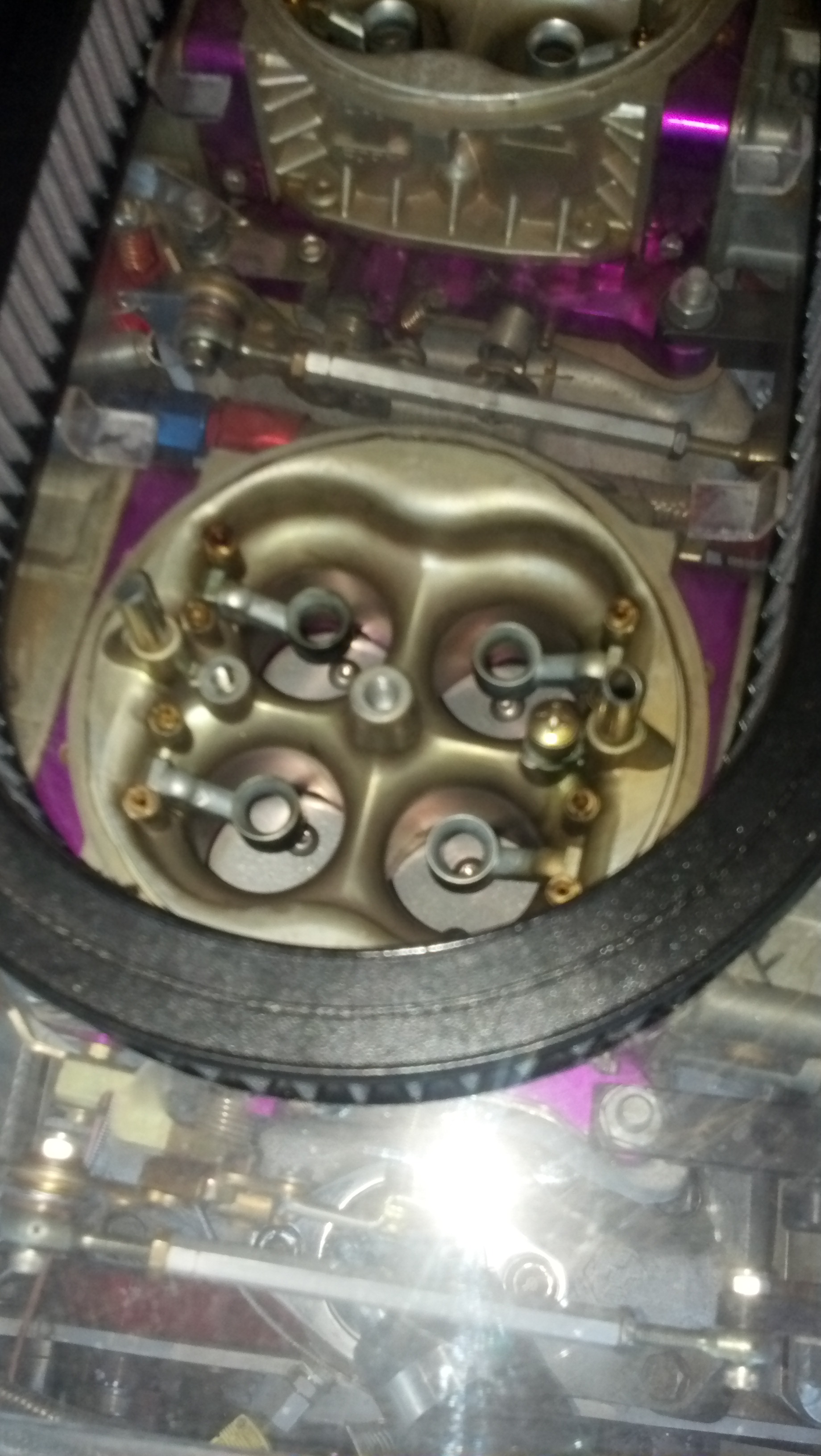

Ohhh man my heart sank when I found this today
Notice anything a little strainge here,,,, (big picts for the detail)
http://www.small-block-chevy.com/ima...2010/UtOh1.jpg
how about here......
http://www.small-block-chevy.com/images/662010/UtOh.jpg

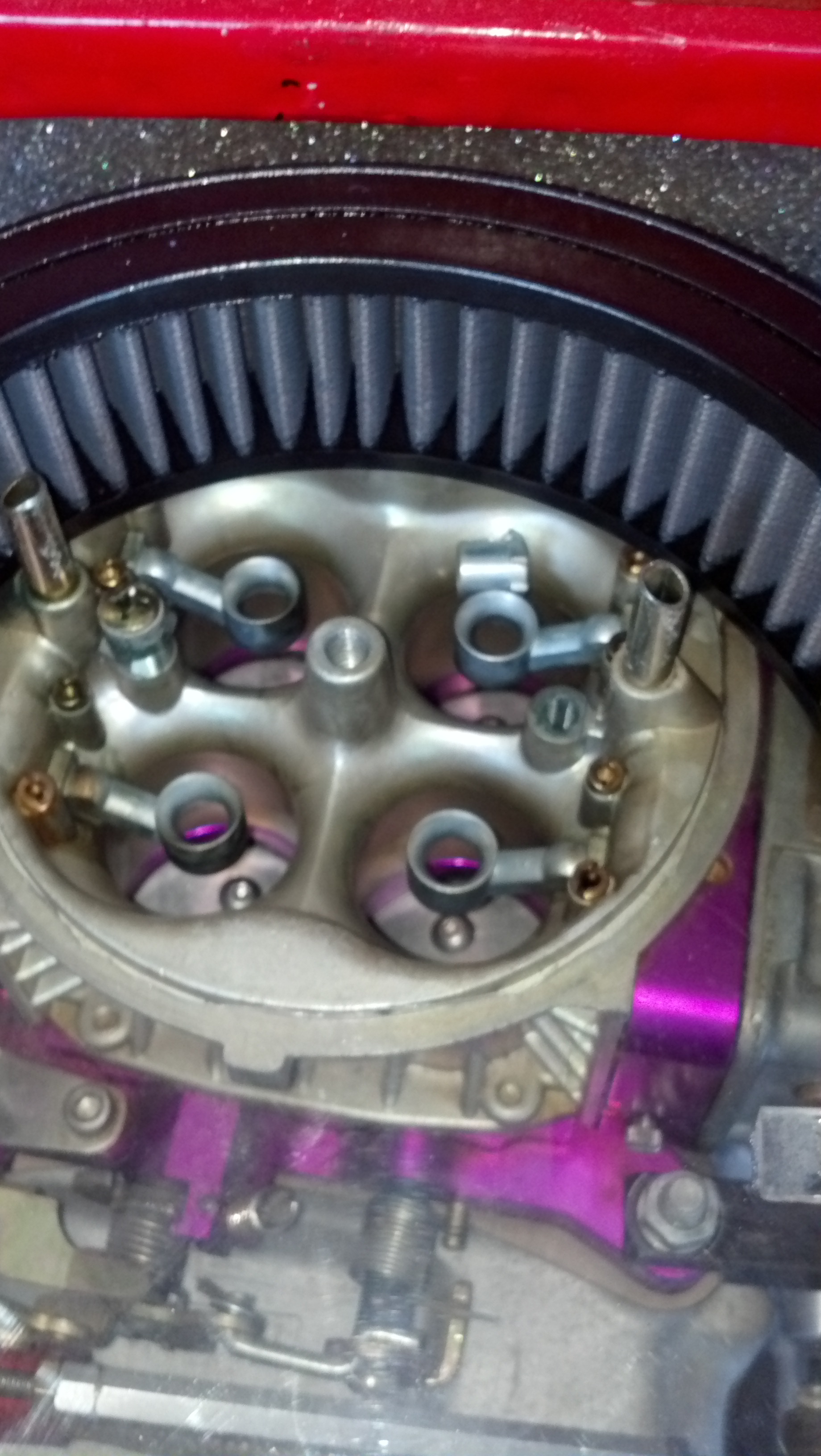

heres a hint.. look what is laying in the back corner of the air pan
http://www.small-block-chevy.com/ima...2010/UtOh3.jpg
Look close other squirter is wedged in the venturi of the rear carb,,, bu NO screws!!!!!!!!!!!! and no where for them to go but into the motor.
I heard a short knock knock knock as I made the turn onto the turnout road at the last race but it went away and the motor ran fine (10.9x all 119all night) figured just a lifter climbing the adjacent lobe or something. Checked the cam end play last weekend and the Hex-sajust bolts,, no problem. So NOW I think I found th esource
Got all the plugs out and #2 and #5 show hint of damage bit not all beat up. Ordering a borescope to decide what to do here. If the new Dart Littel M block is beat up,, I gotta get busy and get teh chassis cert and the trans cert and a bunch of crap up to date on the Nova!!!
Man this is NOT what I needed right now!

ouch....hope it all turns out OK. Those kinds of things can be expensive.
took me the 2nd pic to even catch it.

Thanks guys. Bore inspection scope on it's way.The cheep ones are not much more than the gaskets to open it up and take a look-see. If it hadn't ran only 0.02 slower after I heard the knock knock,,, I'd be more anal about it. I'm sure a couple of pistons are marred up, as is the head (it's a zero decked motor like that would make much difference). But if there is no screws embedded in a piston, or damage that would pinch a ring against the bore,, and leakdown doesn't show something ugly.... well lots of "if's"
I only have 3 more ADRA races this year (Sept, Oct, Nov) . If it hints of being seriosly wounded,, I guess it's inspiration to get busy with the Nova certs for the last 3 races.

Welp, bore-scope here,,,, #5 and #4 wounded. 30% leak on #5 and looks to have taken a hit out on the edge of the piston. Can't see if the wall of the bore is hurt or not.
SO she's coming apart this weekend.
The heads aren't leaking , just a 1/2 a dozen whacks in the quench on #5 and one in #4. Looking around for a head that uses the .10/.45 offset like the 220's and decide if were going to upgrade, or weld em up, mill them down and run em. Truck was really fast enough (If there is such a thing)
