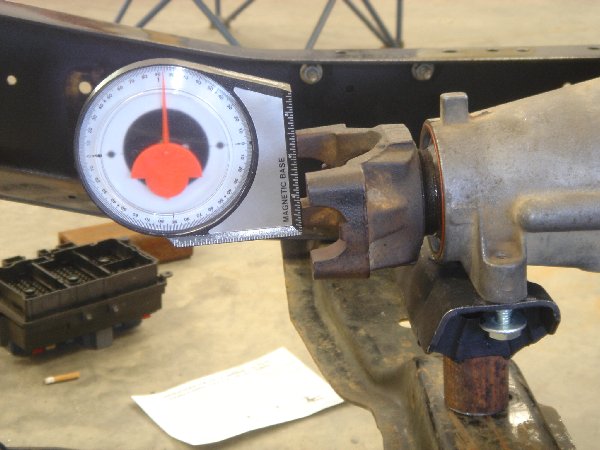

Friday April 7th: Picked up the rebuilt 4L80E from the trans shop. Fuel lines and fittings arrived from Pure Choice Plumbing. Found that one of the fittings were the incorrect size
Saturday April 8th: Late start, Dropped the tranny off and started working on the wiring... AGAIN! The schematics I have apparently don't match the PCM, so I am now having to trace ALL of the wires. While Jamie and I are doing that, my brother is routing the fuel lines/fitting and bending up a EVAP line.
Sunday April 9th: put the tranny in to check clearance for the front fuel lines. Now I need the F-body manifolds to verify they will work, so I am stuck here. Still working on the PCM wiring, got all the harness wires figured out and I am now working on the rest of the lines that I have to find. The missing connectors are KILLING me.

Also, it looks like the engine sits at a pretty severe angle (front to back), is that normal?

I plan to put everything together, make the necessary adjustments/alignments/patches etc and then drive it to work out the bugs and them paint it.
I think that is an illusion. It sits fairly level in there.

BTW Jeff, the angle wasn't an illusion, it was off by 3 degrees as noted below..
Thursday April 13th: Went and picked up a set of F-body exhaust manifolds, picked up some Trans Fluid and found the actual CORRECT pinout for the wiring harness.
Saturday April 14th: Expected to bolt the manifolds on only to find out that they don't work. Started getting ill. Apparently I need to get some headers now. After a bit of a lull, we decided to check the drivetrain angle. It was OFF by about 3 degrees (chassis is not loaded yet). So now I need to make a new trans crossmember. The Tranny tail needs to come up some. Since all of the parts are not yet on the truck, we decided to mock up the frontend and get the tilt ready for mounting and load the chassis and recheck before making a new transmount.
We decided to mount the cab back on and check for fuel line mounting clearance, transmission clearance and firewall clearance.
While we had it on we decided to get the bumper mounted and then get ready to chop the rad support for the tilt frontend. We mounted the '81-87 bumper bracked on the '80 frame and then mounted the bumper.

Chris, progress is always sweet! Is the driveline angle fixed in your recent round of pics? It looks much better...but it could be my eyes too.
How are your trans/cab clearances?
Can't you make a small spacer to raise the tail of the tranny, as opposed to building a new crossmember?
bigblock73 is offline   Reply With Quote
Old 04-26-2006, 06:39 PM   #22
Captkaos
www.73-87chevytrucks.com
Captkaos's Avatar
Location: Birmingham, AL
Posts: 6,935
Re: 73-87chevytrucks pickup.
Yes, it is Mocked up fixed. I am not going to address it until there is enough weight on the truck to get it set.
Cab clearance is TOO much, WAY TOO Much. It is causing ALOT of my manifold clearance problems. I got a look at competitors motor mounts and confirmed my thoughts that the engine mounts are about 4" behind where they would be on a normal SBC. Other motor mounts use plates that let you use the existing mounts and put it back in the same posistion. I am ordering those today. The ECE mounts put the engine 4" forward from the normal SBC posistion, something I DON'T like.
here are the pics:
Anyone need some ECE LS motor mounts?
Trans clearance it TIGHT with the 4L80E. Currently about 1/4" with the spacer I am using to mock the trans with at the proper angle. It came down a degree with the cab mounted and the suspension loaded some.
I could make a spacer, but it will look ALOT better with a nicer trans mount. That won't be finalized until the motor mounts are back in...
