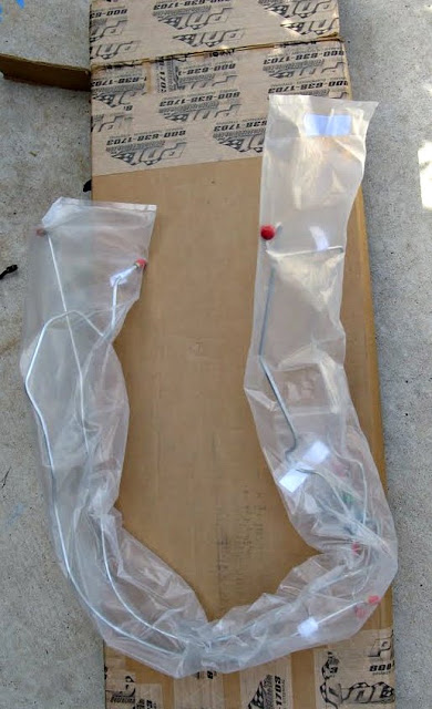

Here is the review on the front Lines.
These are my First set of "pre-bent" lines to install, and from this experience I would do it again in a heart beat.
Some tweaking here and there was necessary, but not much at all, they are a good fit out of the box, (after you unbend the "shipping" bends)
As you can see from the pictures below, I installed these lines not only with my motor in but with Hooker long tube heads on as well. ( I know I'm crazy)
Getting that one piece rear line in-between the headers & the frame rail on the passenger side was twister moment. but doable.
All in all I'm happy I went this route. Take a look at the below pictures and you will see they are a good buy.
Lines right out of the box, "pre bent" for shipping
Label
What you get in the box Left to right
** Booster to passenger side rear brake line cross over
** Booster to Front brake Distribution Block
** Front Driver to Passenger cross over line
** Top bag - 1/4" line plug
** Bottom Bag - Master to Proportional Valve
** Not in picture - Front driver line from Distribution block (6" long)

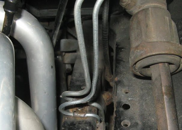

I like how the front line meets up with the rear line before going down to the frame rail
Pre-bent for the stock hold down clamp
This is where I spent the most time tweaking, (10 min)
The rear line "was" hitting with the shock
Clears the shock now
Lines clear the frame & do not touch the cross-member
Front Cross-member fits great
Driver Side cross-member
Passenger Side cross-member
Passenger Side
Getting this side in was fun,
I bent the old rear line a tad to make it easier,
I could of just tweaked the new line, but taking it in and out was not worth it, due to the headers.
