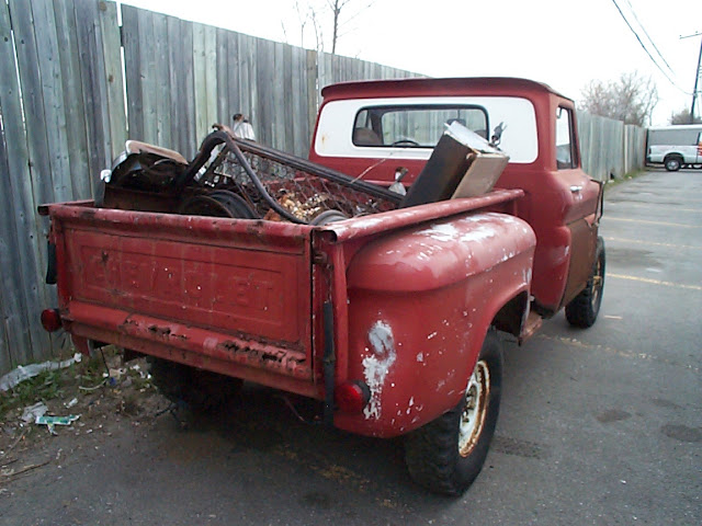

1964 Chevrolet K10. The deal was that I remove the 327 that was in the truck and return it to the previous owner. From a Corvette he claimed, I didn't really care. Fiberglass rear fenders, not original but bonus for a winter driven truck. Braden PTO driven winch.
ATV
I wanted a Inline 6 so I bought a.......
Donor 2:
1966 GMC ( Canadian Built so it had a Chevrolet drivetrain ) 250 Inline 6 Had a few accessories on it as well. You know me and my obsession! Rotten, my God, I think it was returning to the ore from which it was originally conceived. Then I needed a good cab so I bought.....
Donor 3:
1966 Chevrolet BBW Factory Air Cab. Looked great till I had it sand blasted. Who ever did the body work on the floor and the rockers was quite talented, it sure looked great when I went to look at it. To bad he didn't replace any of the perforated floor. I don't really like the 64-66 cabs anyways, so I sold it off with replacement panels and the cab from the 64 K10 as well. Pending the guy picking up the cabs, grounds still wet here.
Donor 4:
You have Craigslist, we have Kijiji.ca. No way as good as Craigslist, but we needed our own identity. Low and behold 1963 Chevrolet C50. 28,000 original miles. Farm truck. 292. Daily driver for the 2nd. owner, who purchased it from a factory farm. It's not at the back of the shop yet, but soon.

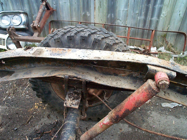

Now I have this shield installed under the front of the frame, and while this is obviously not a stock item, I think I've seen a stock louvered version on some truck's. Can anyone verify it's existance?
Seems that the PO bottomed out a lot on the rear snubber's. Timbrens would be nice, GMRP30 model # suggested from Timbren.

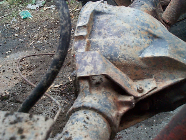

A 4WD. exclusive part? Protects the breather.

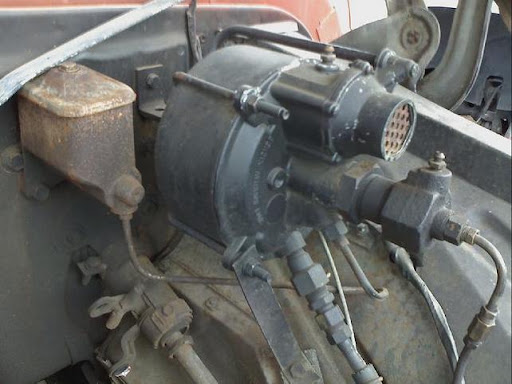

Braden PTO/ Winch/ Control Cable one of the clasps bolts has an insignia on it.

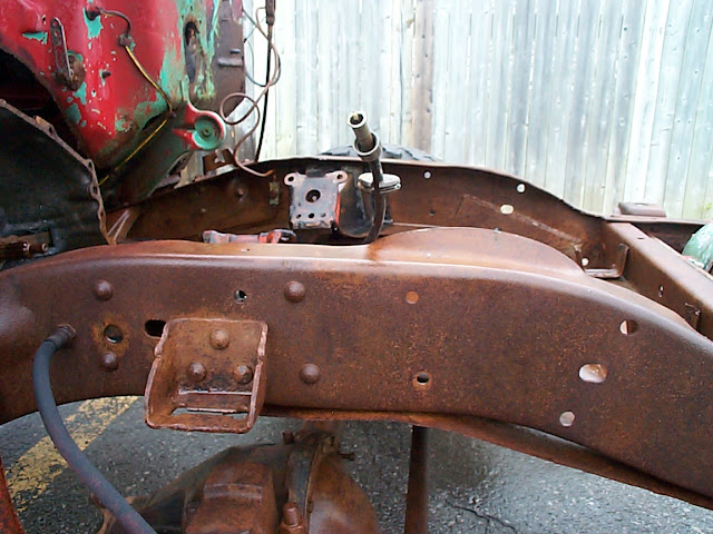

These additional holes in the frame I assume are for the 292 offset motor mounts?

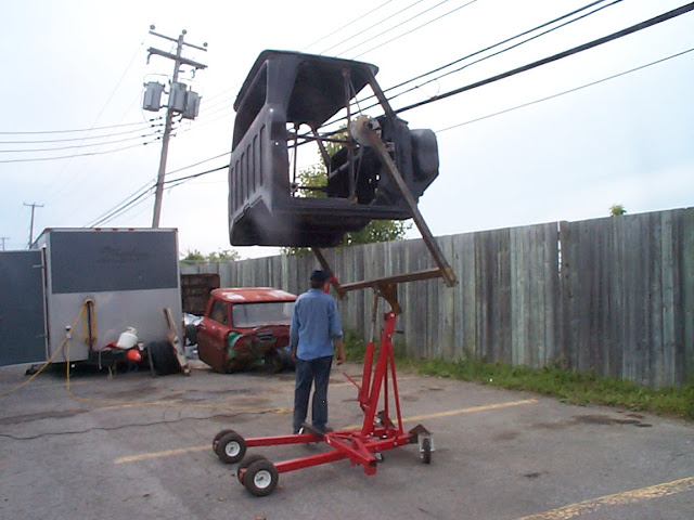

Step 1: Found an old fencepost on the side of the road. Cut 2 notches to fit between the 2 seams where the door weatherstrip adheres. Took a piece of 4" channel and welded to flanges with holes. Removed the bolt holding the chain on my engine hoist and bolted the channel to the end of the arm.
Step 2: Raise the cab. Didn't have to take the 4 speed shifter off. Lifted the cab in the air, then pulled the hoist out from under the frame. Moved the frame back from the cab and lowered the cab closer to the ground.
Step 3: clean the portion under the cab I couldn't reach before!

The picture you posted of the bracket that protects the rear differential vent / breather, do you think that is a factory piece?

If it's not factory, all the bends are right on the money. We'll see if anyone has this on their trucks.

Installed the 292 passenger side offset mount after straightening out the frame.

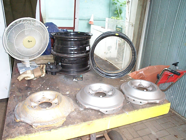

Installed the 1 modified 17.5" converted to 17" rim with tire, all clear so I'll do the other 3.

Sand down the rust, treat the metal, paint. It's going to take more than a quart! And more patience, next time sandblast and shoot the paint on.

Installed a larger set of wheels to my hoist this weekend. Much easier to move things around.Replaced the bottom hydraulic cylinder bolt with a trailer hitch pin so I can rotate the cylinder for working the pump mechanism from either side of the mast. Replaced the bolt for the arm extension with a hitch pin and the bolt that holds the chain at the end of the arm with a hitch pin as well. No problem with clearance on the 4WD or the C50 Donor that's coming sooooon... Moved some stuff between my parents place and work, seems they think a 66 BBW cab is unsightly in the driveway. Like their ever awake long enough to see it. Stripped out the centers of the three remaining 17" rims and finished off a second with the 17.5" center welded in using an old brake drum lathe that they were throwing out at work. 3 day weekend here so I'll finish off the two remaining rims tomorrow.
Old 05-23-2010, 08:38 PM   #21
Bears63
...just another truck junkie..
Bears63's Avatar
Location: Watertown, SD
Posts: 698
Re: aerotrukII,3&4
Great build, aerotruk. One question.... How does the hoist handle on somewhat rough ground with those wheels. I was thinking of doing the same to my hoist in the hopes that it would move a bit easier on rough areas, like a barn floor.
Mike "Bear" Shea
Bears63 is offline   Reply With Quote
Old 05-23-2010, 08:52 PM   #22
aerotruk63
Check The Champ, Demonstrator
aerotruk63's Avatar
Location: Montreal,Quebec
Posts: 6,625
Re: aerotrukII,3&4
Exactly the reason why I did the modification. I was frustrated with the hoist as the small diameter solid wheels lock into every crack. Now it floats over semi solid surfaces. Unless you have a polished concrete floor the original casters are useless. I am going install the original casters back in front of the duals but higher than original, perhaps leaving only an inch between the bottom of the square tube to the bottom of the solid caster for lowered vehicles. There is only a slip pin to remove, in order to remove the duals, to drop the section that travels beneath a lowered vehicule.

Took the hoist across the grass this morning with the cab on the arm. Met some resistance but nowhere near the solid wheels on asphalt. Sorry, but new toy, had to rave.

Are you doing your wheels(on the truck) by yourself?
If so I would like to see how it's done.

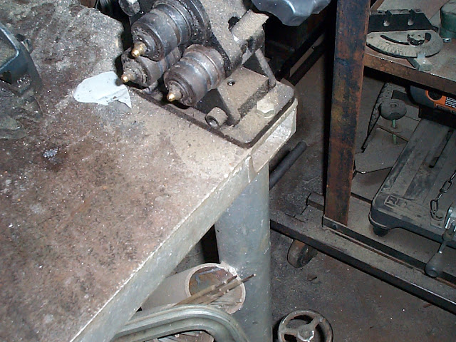

There, took two of the four solid steel casters I removed and mounted them recessed but flat with the top of the square tubing. There's 1" clearance between the bottom of the square tube to the ground. That gives me 4" of clearance required in order to get the hoist under a lowered car. All I have to do is remove one slip pin to install or to remove the flotation tires for regular stuff.
